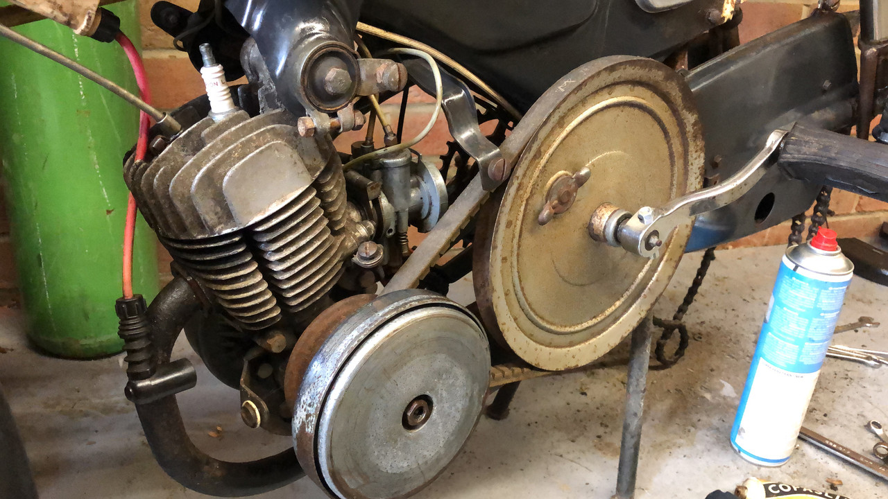

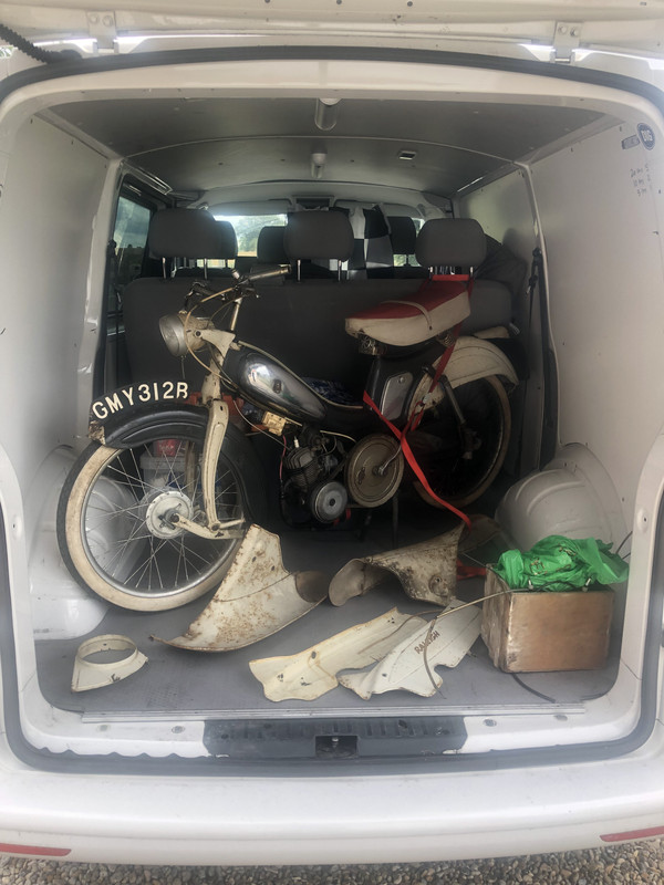

My Dads RM5 that had not been on the road for 30years. We fitted a new condenser and points, new plug, re set the timing and with a bit of fresh fuel she ran!

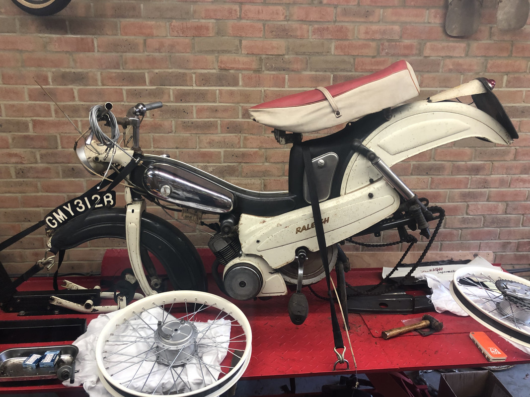

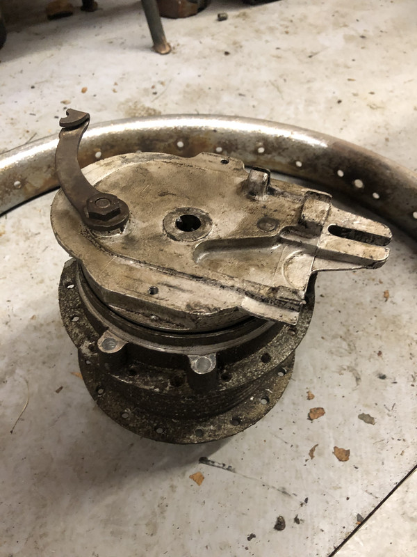

Wheels were a right state. Stripped, vapour blasted, rims powder coated as the chrome was well past it. Re spoked and a nice set of white wall tyres fitted

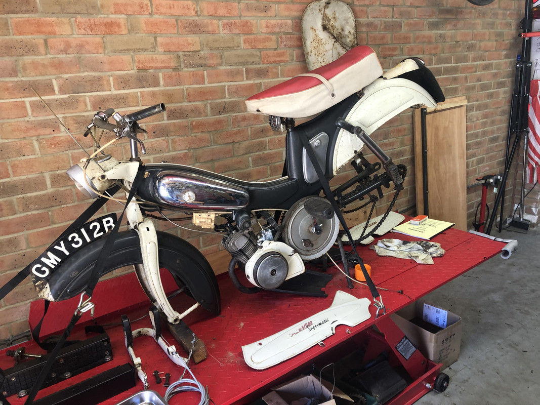

The frame was pretty solid, just an oily rag was all that was required! The fork elastics needed to be replaced which was a pain to do. Tank cleaned out. New carb fitted and cables all round.

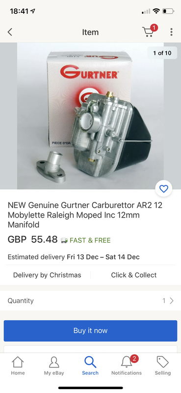

What carb did you replace the old one with?
Post by Admin on Dec 10, 2019 18:44:12 GMT
I put one of these on but have since been told the original is better so will get it cleaned up and swop it over and see if it runs as well
