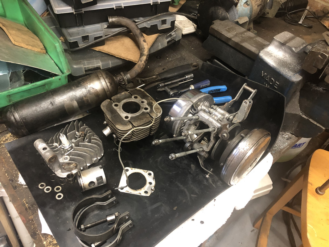

After lots of rides I started to have a few issues with power loss and so thought as it’s 50years old it could just be worn out and so ordered an Airsal 66.5cc barrell and piston for it
